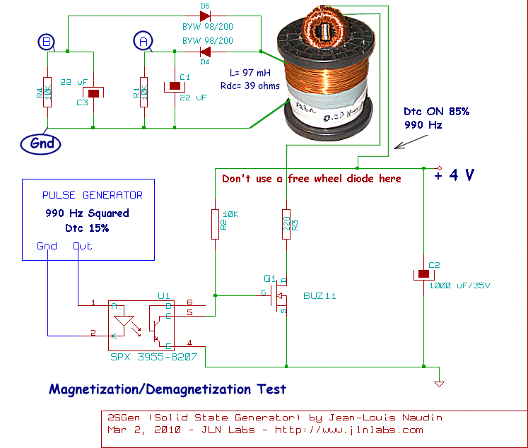

Its a method used by JL Naudin in his 2Sgen project (Solid State Generator) from 2010 shown here: http://jnaudin.free.fr/2SGen/html/s2genep7en.htm
JL Naudin references a paper written by Nikolay E. Zaev where the theory behind this is explained: http://jnaudin.free.fr/2SGen/images/demag.pdf
Jagau mentions a difference ratio (calling it the: "magnetic power coefficient") of 27.77, while JL Naudin found 13.7 and N Zaev 16.3.
The measurement uses a 10K load resistor with a 22uF capacitor parallel on both the magnetization as the demagnetization phase, see top part diagram:

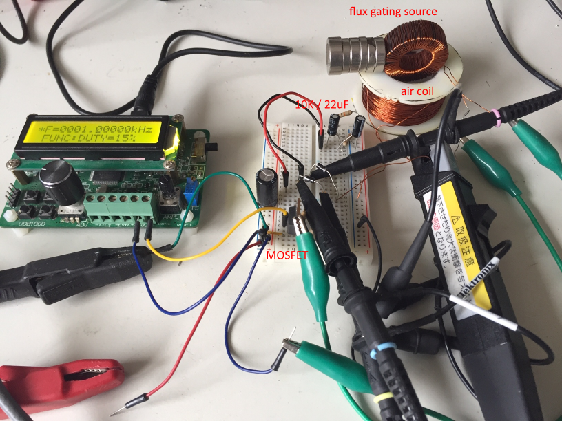

Anyway, i tried to replicate this setup by using a finemet (Nanocrystalline) FT-3K50T ferrite toroid as the flux gating source:
mu = 50K @ 1KHz
Coil 200 turns
L = 618mH @ 1KHz without any neo magnets attached
L = 395uH @ 1KHz with a stack of neo magnets attached
R = 1.1 Ohm
The air coil:
L = 16.3mH @ 1KHz
R = 12.5 Ohm

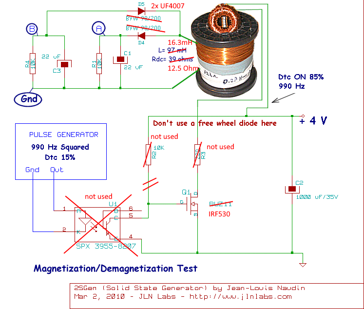

Using 2x UF4007 as diodes, 2x 10K resistors, 2x 22uF caps and an IRF530 MOSFET with 4V on drain see modified diagram:
i get the following voltages on the 2x 22uF caps:
4.184V (magnetization) and 11.33V (demagnetization) and thus a "magnetic power coefficient" of 7.33 (11.33² / 10K) / (4.184² / 10K).

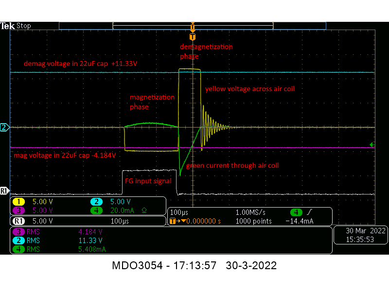

The screenshot shows:
White:  the gate signal into the MOSFET (1KHz @ 15% Duty Cycle)
yellow: the voltage across the air coil
green:  the current through the air coil
blue:   the DC voltage on the 22uF cap at demagnetization
purple: the DC voltage on the 22uF cap at magnetization
So its seems that we have more energy out of the air coil then was put in.

good catch, the voltage seems to be clipped to about 100V, see screenshot 1 (yellow voltage drain, green current through input coil).
But the focus is not the overall COP,  but the COP of the air coil input / output (building / collapsing magnetic field).
Screenshot 2 as with the same time base as in above earlier screenshot

I measured more accurate the several data using cursors on the scope and my Fluke 179 DMM, see table:
It seems the discharge time is much less (4.4us) then your estimate (8us), see screenshot where i zoomed in:
So the discharge energy is less then the input consumption!
But this shows uJ (micro Joules) while my aircoil charge / discharge energy shows mJ (milli Joules), so something is wrong here.

OK, thanks for taking those measurements.  The discharge time was the major source of error in my calcs however, let's take your input energy of 457uJ and your discharge energy of 268uJ which leaves us with a net energy consumption of 189uJ.  Please note that the energy lost in the avalanche of the IRF530 does not to be that way.  The discharge energy could be captured in a capacitor of proper value at a voltage just below the level of avalanche.  This cap's energy would have to be periodically drained back to a/the power supply so the voltage remains below avalanche levels.  This is just one solution.
Then let's take the sum of your energy calcs for C3 and C1 of 193uJ and 1.412mJ respectively which equals 1.605mJ .  I see no other source of energy to your device so the apparent COP = 1.605e-3/189e-6 = 8.49!

See the attached, it should explain what is happening.
Note that JLN's toroid is inside the solenoid along with the magnets, the magnets are the source of energy "compress and release".

Right, i agree,  but the overall COP was not the goal in the first place.
The goal is to show that in the air coil, the energy to create the magnetic field is less then the energy available when this magnetic field collapses.
My replication shows this is so, a real Solid State Generator, but one of the questions i asked in my opening post is if this method is the correct one
to measure the energy to build the magnetic field and to measure the energy in the collapsing magnetic field.

I choose to put the toroid ontop of the air coil with the magnets attached to the toroid and it seems to show the effect (generating energy).
My question is if the method i use to measure this (more energy out of a collapsing magnetic field then was put in to build it) is the correct one or that i get fooled somehow.
